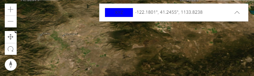

Thanks for the reply, Robert. However, this changes the select. I want to change the select button as seen below

Richard,
Hmm... That is exactly what it does for me.
RichardRhone
That's the result i got too. However, I actually want to change the button circled below to blue
RobertScheitlin__GISP
MVP Emeritus
Ah. So you want this then:
.esri-coordinate-conversion .esri-widget--button {
  background-color: blue;
RichardRhone
Thanks Robert!   This resolves the issue.
