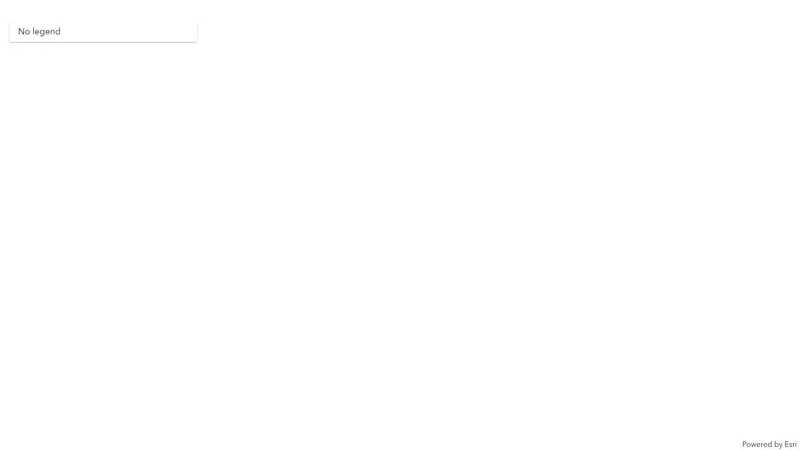

Here's an example where I did something similar with NYC's boroughs, where the clusters are colored based on the number of boroughs represented by each cluster: https://codepen.io/annefitz/pen/dPbZVpP?editors=1000
