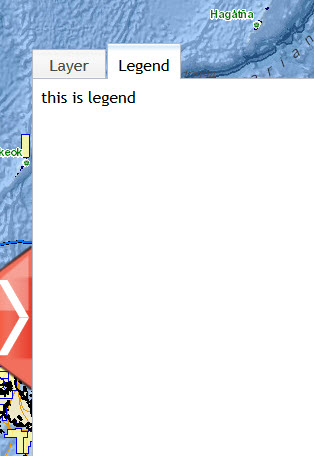

here is the actual result, the content is harcoded.

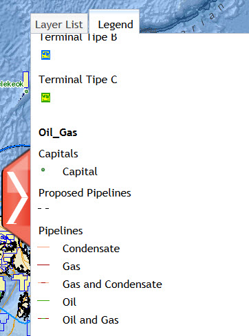

here is my expectation :
I did it using declarative method, could anyone please advice me how to assign legend content using programmatically method ?

Just as you use the "addChild" to add the ContentPane to the TabContainer, you add information to the ContentPane with "addChild"
legendMenu.addChild(legend);
