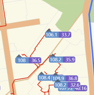

how to add multiple popups on map in JS sdk v4.x
282
12-25-2024 12:48 AM
baohuachu7
I has searched in the community, many guys have this requirements but no answer.
The context is as the screenshot attached.
nafizpervez
Typically, you can manage multiple pop-ups by manually setting their content and ensuring they open at different locations.
  1. Add Multiple Graphic Overlays
    You need to create Graphic objects, each with its own location and content, and add them to the map. You can then associate each graphic with a pop-up.
  2. Create a Graphic with Popup Information
    You can create a Graphic object for each point on the map, with a custom pop-up configuration that will display relevant information when clicked.

baohuachu7
Hi nafizpervez:
    As the code above,the popup only open when it is clicked. Any method to open all the popups of graphics?
