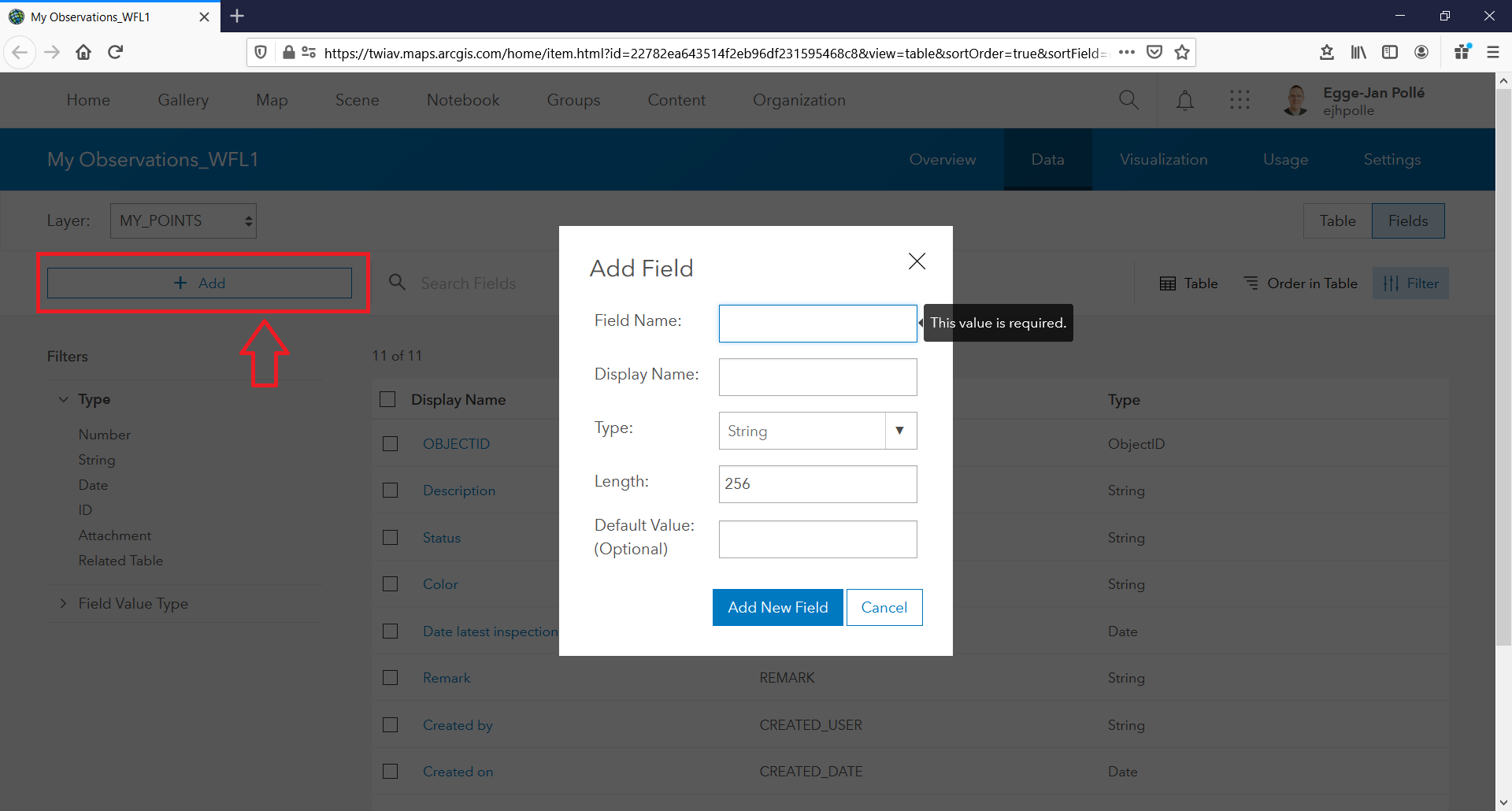

Assuming that your Feature Layer is hosted in ArcGIS Online, these are the steps to follow:
  • in ArcGIS Online go to the item page of your hosted feature layer
  • go to the Data tab and select the layer you want to modify
  • click Fields to see the existing fields and their properties
  • here you will also find the Add button to add a field
  • after adding the field you can optionally create a list of values (domain) to limit the input to the new field

Since it's not clear whether you are wanting this workflow for use in ArcGIS Online or ArcGIS Pro, I will outline the process within Pro as well.
  • Open the attribute table for the feature layer in question.
  • Hit the Add button, outlined in the image below.
  • This will then allow you to specify the field name, type, and format.
