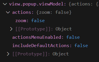

GregoryBologna
Check the node list. It should be there. If you're using VSCode, you can add view.popup.viewModel to watch window.
