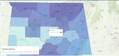

Hello,
First, let me say that I am NOT a pro developer, but wanted to see if this problem might have a solution. I'm developing a javascript web map and am including a hover-pop up function. However, I'm experiencing a "blocking" effect by the hovering pop up. This "blocking" effect of the pop up is preventing the pop up from appearing for underlying features.
I added this screenshot to help convey what I'm trying to explain with "blocking"
Rice_GIS_0-1663251430828.pngRice_GIS_0-1663251430828.png The pop seems to block the pop up from opening the new pop up for the other feature behind it.
Code for the hover function is attached. Is there a way to add a code for the map to "listen" for features that might be underneath the pop up?  Thank you in advance!
