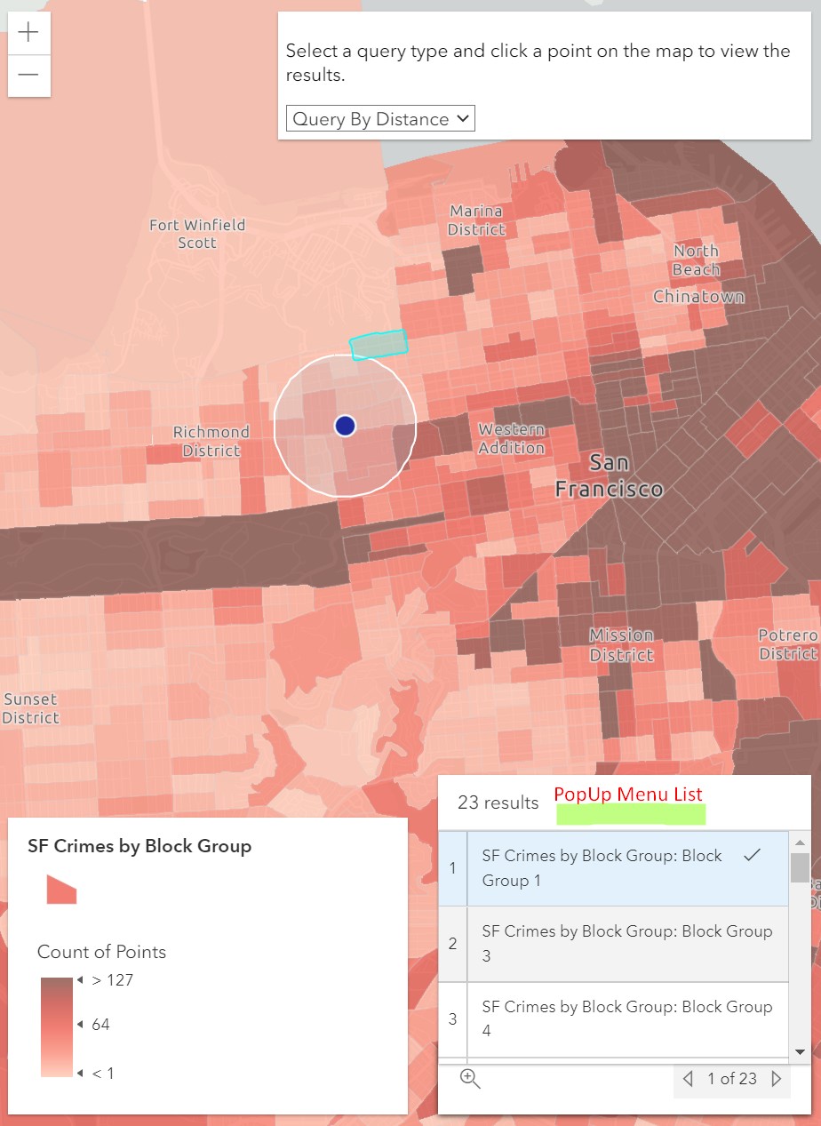

I am trying to achieve this:
click on any point in the map, gives a popup menu list (no problem in this part).
Then if you hover on that popup menu, you will see the corresponding feature highlighted on map.
I am stuck with the hover on popup part, any help will be highly appreciated

UndralBatsukh
Hi there,
This is not possible out of the box in the API. We can look into adding this for the popup feature menu. However, I do not know if this will be implemented or when it will be implemented. If we add this feature, I will be sure to update.
In meantime, do you think you can use approached used in this sample? https://developers.arcgis.com/javascript/latest/sample-code/sandbox/?sample=featurelayerview-query
You could update the sample to listen to mouseover event of the listNodes. listNode.addEventListener("mouseover", onListClickHandler);

LaurenBoyd
Hi @rabeya08 -
The functionality to highlight features in the map that are corresponding to a hovered item in the popup feature menu will be available in version 4.24.

LaurenBoyd
@rabeya08 - you can see the new functionality with the "next" version of the API. Here is the sample above showing the new highlight on feature menu hover functionality:  https://codepen.io/laurenb14/pen/BaYZBxW?editors=1000
Lauren
