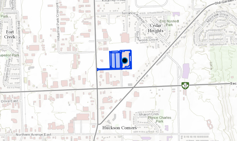

I have a map with a mix of points and polygons:

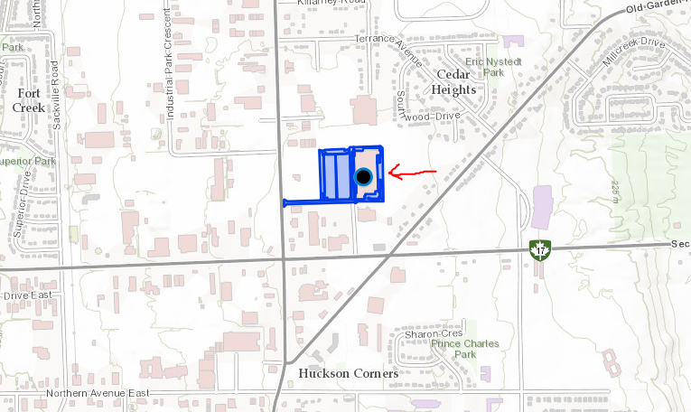

If I zoom out and try to select a polygon near the point, the point will almost always be included in the Hit Test, to spite not overlapping the polygon.  In this case I was trying to select the area pointed to by the red arrow.
If I look at the hit test I see two elements, are obviously the point and the polygon:

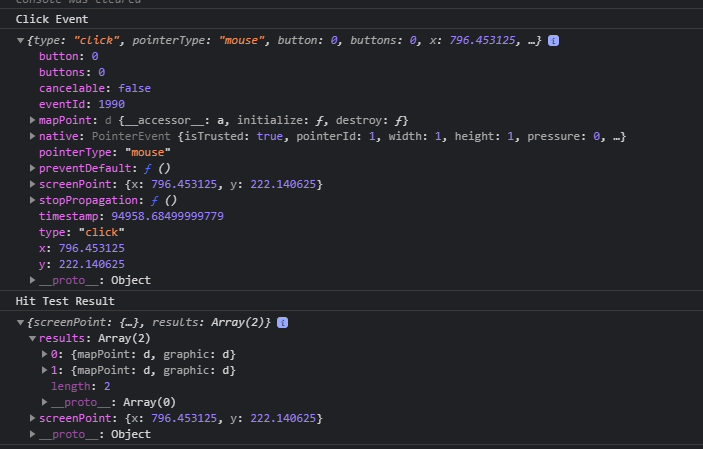

My question is, how do I query the correct object?  It has the screen point, which I assume has to be the tip of the mouse pointer, so is there away to correlate that again the objects returned from the Hit Test?
This is core part of the Hit Function:
clickHandler() {
this._view.on('click', (event) => {
console.clear();
console.log('Click Event');
console.log(event);
this._view.hitTest(event).then((response) => {
console.log('Hit Test Result');
console.log(response);

ReneRubalcava
Esri Frequent Contributor
You could search by geometry type if that's what you're looking for.
// by geometry
const result = results.find(a => a.graphic.geometry.type === "polygon");
// by layer type, vector tiles are included in hitTest
// so this will rule that result out
const result = results.find(a => a.graphic.layer.type === "2d");
AndrewMurdoch1
Thanks for the suggestion, I can play around with that idea and see where I can take it.
