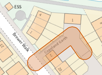

I currently have a working hitTest,  a customer moves their cursor over a street (from our streets feature layer) and the whole of that street will highlight in orange (based on it's unique street code).
I've been asked, if the highlight can show as different colours based on an additional attribute in the layer: ownership. Therefore blue if privately owned, and orange if owned by the council. This data is in the feature layer:  field:  customer_n   and the values are:  HW: Private  and HW: ERYC Highway Maintained

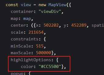

My code for the hitTest is below: the current orange highlight is set in the MapView: I'm wondering if I can put the relevant code into the highlight options as this is where the highlight/color is controlled?

You could to something like the following, however, I must admit that this is probably not supported. You can check the attribute value and reset the MapView.highlightOptions object before you setting the layerView.highlight.
if (valueOfSomething <= 80){
  view.highlightOptions = {
    color:[160, 32, 240]
else {
     color: "orange"
ITApplications

You should change the highlight colors in your if then statements
Like here: if (value = HW: Private)
if (value = HW: Private) {
 Here is a simple codepen app shows how it is done: https://codepen.io/U_B_U/pen/poVLyzr?editors=1000
