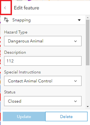

Hello,
I'm working in 4.25
Does anyone know how to hide the back button on the editor widget? I imagine this can be achieved with CSS?
Thanks in advance for any help!
dcarson1661
Thanks for the response. I'm not sure I fully understand though.
From what I can tell the Editor widget is housed inside a Calcite Flow component which has a Calcite Flow Item nested in it. This is where the back button comes from. The Calcite Flow Item does have a property for "show-back-button" which I can set to false, but only after the element is actually added to the page.
My current work-around is to watch for any changes to the page and then set this property to false if the tag name is "calcite-flow-item".
This feels very hacky and I'd prefer a solution that sets the CSS  to hide this element, but I'm not sure how to go about that.
