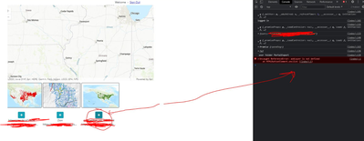

Can someone help me with understanding why the addLayer() function is not working in my code. In the console it says it is not defined. JS API 4.18. I’m a bit new to JS and self-taught coder. So please bear with me.
I can only get it to work when the addLayer() is outside of the <script> tag that includes all the ESRI API stuff. I’ve tried to put it everywhere in those scripts tags, only works when it’s outside of it. The function will eventually include code from the API. *note that I just put the addLayer() function in numerous locations in the code.
What I’m trying to do is get users to be able to add their own content to the WebMap, then eventually print it out. Anyone else have any ideas how to do this. I know WAB builder has a nice widget that lets you add your content.

Well, you also have 3 'addLayer' functions, 2 existing under the 'createGallery' function, and 1 existing at the main script level.  But there's nothing calling an 'addLayer' function, nor is there anything in any of the 'addLayer' functions that's actually performing an addlayer on the map, just console.log references.

I have those function in there 3 x because I was just showing that I tried different locations.
Yeah I'm just trying to get the function to work before I work on the actual Add Layer functions.
error
