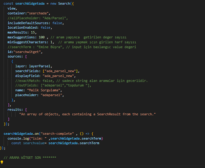

Hello How can I get the entered text value with searchWidget?
1307
05-20-2024 04:50 AM
emreaktas1
Hello
// js code
ReneRubalcava
Esri Frequent Contributor
You can check the searchTerm property
https://developers.arcgis.com/javascript/latest/api-reference/esri-widgets-Search.html#searchTerm
It just depends on what event you want to check it
https://developers.arcgis.com/javascript/latest/api-reference/esri-widgets-Search.html#events-summar...
searchWidget.on("suggest-start", () => {
  console.log("term: ", searchWidget.searchTerm);
searchWidget.on("suggest-complete", () => {

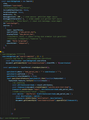

emreaktas1
I want to show all my values ​​in the search result in a container. How can I show this?
Can I get the returned values ​​with the following code?
layerParsel.queryFeatures(query).then(function(featureSet) {
    featureSet.features.forEach(function(result) {
 //do something
emreaktas1
How can I show search results in a container?
// js code
