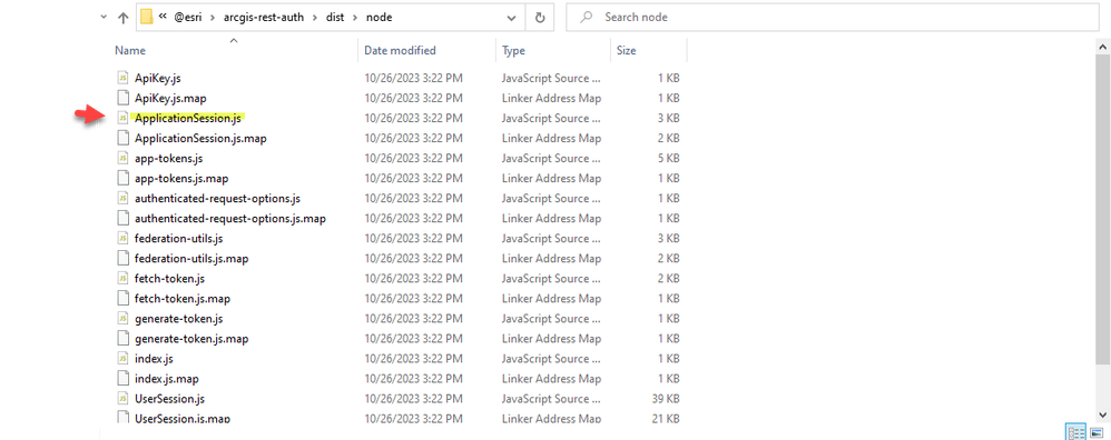

This leads me to believe there is a problem with ApplicationSession.js? I've double checked my node directory and see it exists. It is in this directory (which is in a subdirectory of my main project):
Can anyone point me in the right direction? I've been lost on this for the past few days and am not sure how to move forward from here.

OK I took a look and followed the documentation here.
https://developers.arcgis.com/documentation/mapping-apis-and-services/security/app-credential-authen...
I did an npm install @esri/arcgis-rest-auth.
Which installed the node package in directory within my project and has ApplicationSession.js.
In my code, I have it imported here:
 require([
        "esri/Map",
        "esri/views/MapView",
        "esri/layers/FeatureLayer",
        "esri/identity/OAuthInfo",
        "esri/identity/IdentityManager",
        "esri/arcgis-rest-auth/ApplicationSession",
I'm still unsure why this isn't being recognized.
