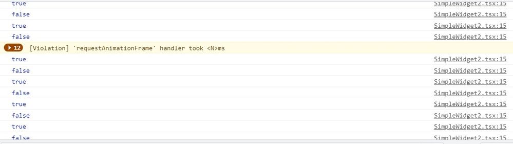

Hey Andy, thank you for the answer.
To better understand creating widgets and what went wrong, I made a skeleton widget, a toggling button.
I still experience hectic behavior, while not clicking once it's still flickering "on and off".
how do I correctly use the toggle function?

litch
so I tested the code by myself and the string did change.
but the main problem I had was behavior.
adding a log to your code revealed that it was still calling the function multiple times without clicking.
private _toggle(){
        console.log("test");
        return this.msg;
^only change I made.

adding "bind={this} " which I found in Esri repos worked!

id like to better understand why your code calls the function multiple times and how can I control it,
in my original widget functions are supposed to create an HTML element once, toggle, query, and listen.
the problem is the multiple and unintentional function calling.
