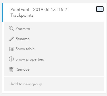

Map Viewer Beta exposes this under the layer options after its been added to the map, then you can drag more layers into it. We also support web maps published from Pro with group layers as well.
