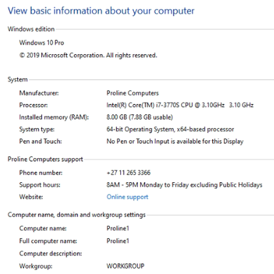

Yes, the apps with graphic layers work on other PCs.  It is only this one that is a headache.
- PC make and model >> Proline (desktop)
- Operating system and version

@FC_Basson that processor actually came out in 2012 so it's probably 11-12 years old 😅. That said, I know we have an old Intel hd 3000/4000 device in storage somewhere as I remember installing some workarounds related to those in the past.
