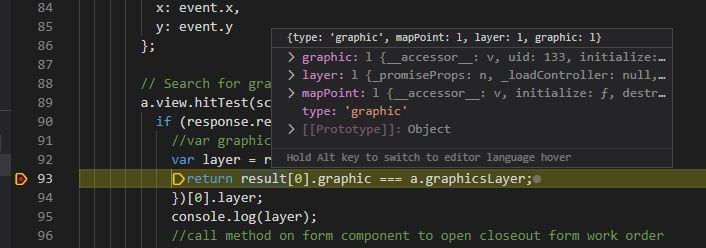

strangely, when I break on result I see a graphic property (see below).  Any ideas how to get this to work?

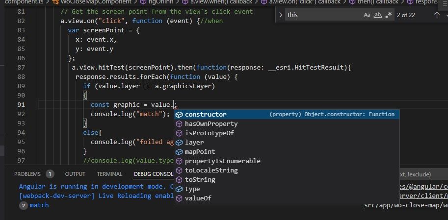

Thanks Rene - maybe this is a typescript thing -- do you know of any other methods I could try to access graphic attributes of a clicked graphicsLayer other than hitTest?

PeteVitt
no graphic propertyHitTestResultIntellisense.jpgHitTestResultIntellisense.jpg
