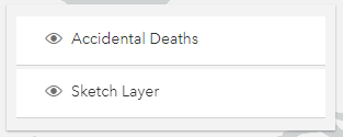

In my custom map application, I would like to use a portalItem in the WebMap and show a graphics layer (for sketch widget) above this portalItem. I want to use the WebMap portalItem as I have specific graphs and custom text in the popups.
I tried changing the order of adding the portalItem and graphic layer but it does not change this in the Layer List.
const webmap = new WebMap({
webmap.portalItem = {
webmap.layers.add(graphicsLayer);
or
still shows
As it is now, when I draw a graphic using the Sketch widget, the features from the portalItem overlays the drawn graphic.
Is there a way to have the graphics layer above the web map (portalItem)?

I managed to sort this out. I added the webmap.layers.add(graphicsLayer); into a view.when() to load only after the webmap's portalItem is loaded.
const graphicsLayer = new GraphicsLayer({
    title: "Sketch Layer"
    // autocasts as new PortalItem()
const view = new MapView({
  map: webmap,
  container: "viewDiv"
view.when(() => {
