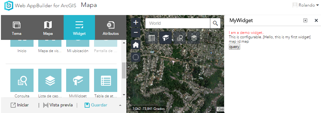

Look Robert, I modified this:
I suppose that this.widgetId make reference to widget that I'm working (MyWidget). All this are in MyWidget folder

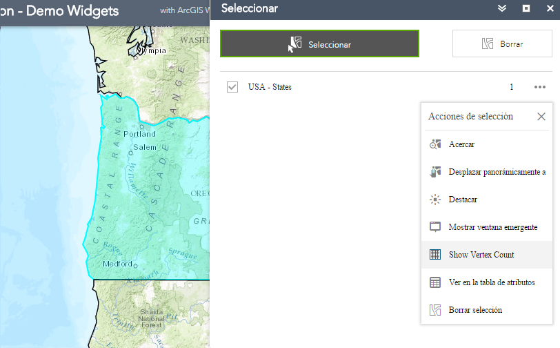

I did it the same like Demo widget, that interacts with Select widget. (maybe I'm wrong)

  Is your widget opening?
RolandoFlorez
yes Robert, when I click in query button, must print arrVal

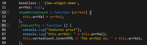

Now, arrVal is a global variable and _theLastTry runs when I click query button (Widget.js)

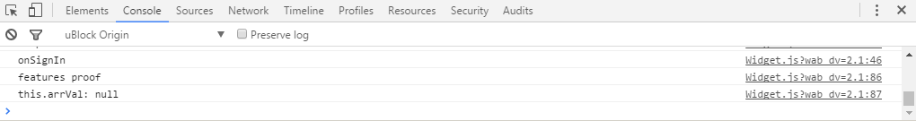

   Have you tried putting a console.log(arrVal); in your showVertexCount function?
RolandoFlorez
Robert, I just did it, but it doesn't work.

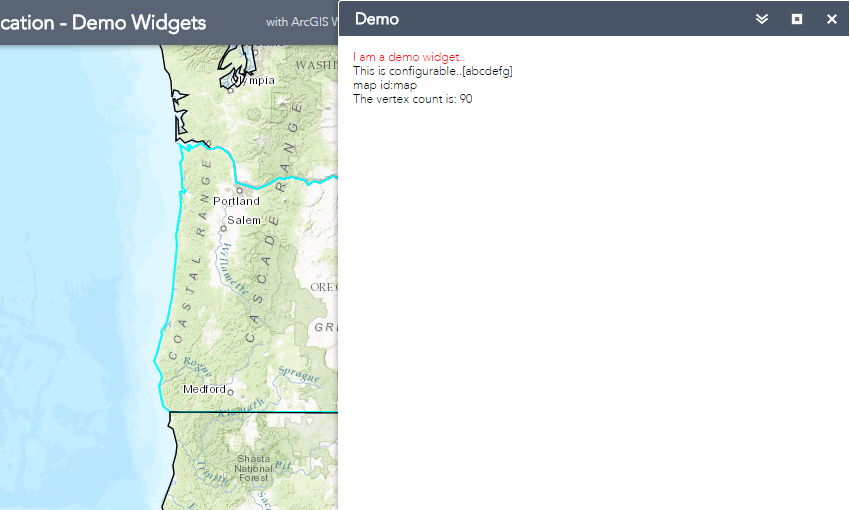

Look, I want to do this (but with arrVal)
if you have any idea, It would be great.
RobertScheitlin__GISP
MVP Emeritus
Rolando,
   So did the console print null for that console.log line?
RolandoFlorez
Yes Robert, it prints null
