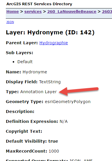

I'm wondering if there's an easy way to get the layer types for all the layers in a map service. By layer "type" I mean: Group Layer, Raster Layer, Annotation Layer, Annotation SubLayer, Feature Layer, etc..
When I check the layerInfos array of my ArcGISDynamicLayer, it will tell me the layer id, parent id, etc.. but it won't tell me what the layer type is. I know I could create a FeatureLayer for each layer to get this info, but that would generate more then a hundred requests since the map service has several layers.
