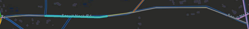

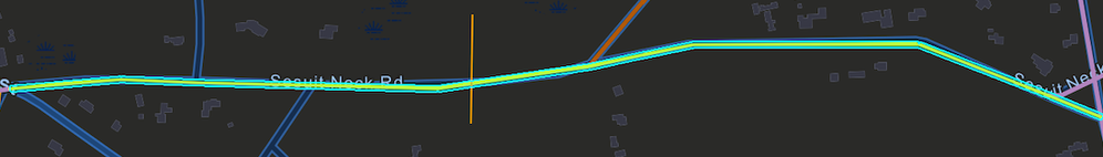

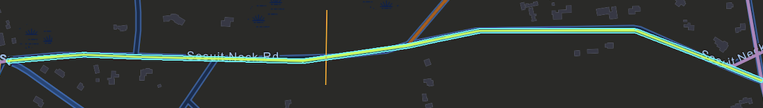

I am trying to cut a Polyline feature/graphic with a Polyline geometry using the geometryEngine.cut method of the ArcGIS Maps SDK for JavaScript. The problem is that the cut method splits the segments into multiple wrong fragments.
This is how the feature looks before splitting. The orange polyline is the cutter.

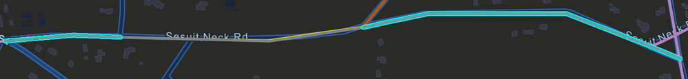

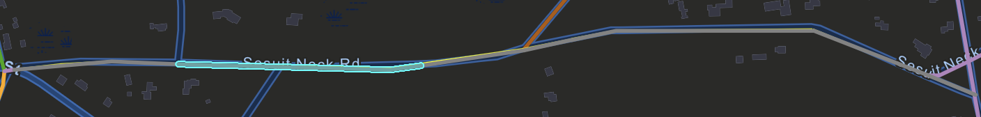

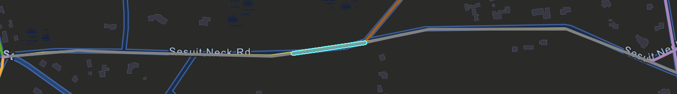

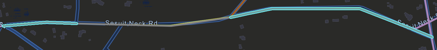

The cut returns three fragments
See that the last fragment is on both sides of the cutting polyline, which is wrong.
