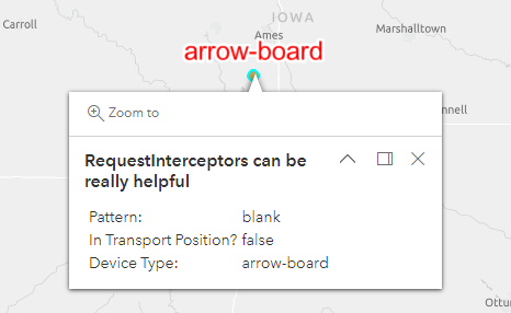

Did you ever figure this out? Is it possible. I have seen some GEOJson examples that have an object but not how to access it.
BjornSvensson
Esri Alum
It's not possible to use fields inside an object directly.  However, you can use RequestInterceptor to flatten the field structure so that you can use the field data from inside field objects.
See for example https://codepen.io/bsvensson/pen/YzjaKQg?editors=0010 -- which uses RequestInterceptor to create new fields like "core_details__device_type".
cc: @JulianDurantini , @ScottSurber
[Update] Looks like @UndralBatsukh already answered this in the original issue post -- https://community.esri.com/t5/arcgis-javascript-maps-sdk-questions/geojson-layer-property-is-an-obje...
