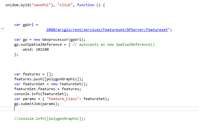

MuhammadFayaz
Dear Robert,
I have a simple geoprocessing service which append a feature set into an existing feature layer in geodatabase. I test the service with web appbuilder and works fine. But i am unable to use it from my javascript app. My attempt is attached.
I wish this is the last time i am taking your precious time.
Please let me know if you need full code or service link.
Thank you!
