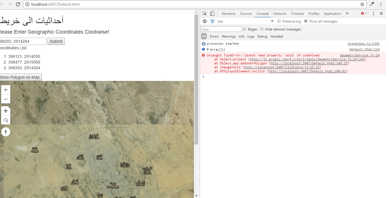

MuhammadFayaz
Dear Robert,
What if i want to use UTM projected coordinates to place graphics. I tried to change the spatialReference  to  { wkid: 32638 }. But it is not working..
It might be easy but i am new to custom development.. Any help!
RobertScheitlin__GISP
MVP Emeritus
Muhammed,
  It would look like this then:

MuhammadFayaz
Dear Robert,
I tried it but got the error  "Cannot read property 'wkid' of undefined".
