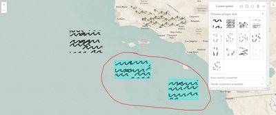

This sandbox shows you how to draw polygons:
Sandbox | Sample Code | ArcGIS API for JavaScript 4.24 | ArcGIS Developers
However, I can shift click them to select them.  Here I have selected 2 out of the 3.
Is it possible to find out what polygons you have selected?
UndralBatsukh
Hey there,
You can listen to Sketch widget's update event  and its payload returns array of selected graphics.
sketch.on("update", (event)=>{
  console.log("selected graphics for update", event.graphics);
UndralBatsukh
Hey there,
