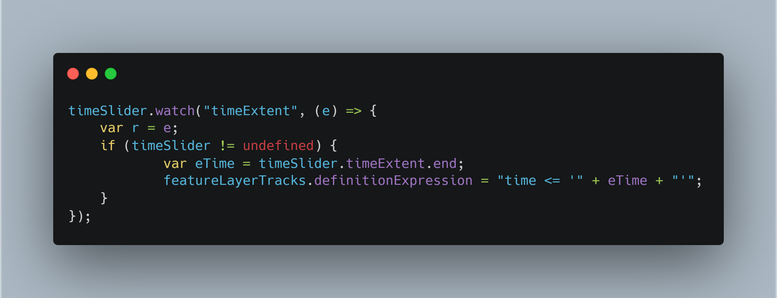

Hi, you could apply a definition Expression to the featureLayer, this can be done on the timeslider change, using the time extend, that way the feature table will show the same features than the time slider.

That is what I ended up doing.  I also had to format the date some to make it work with the definition expression.
