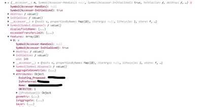

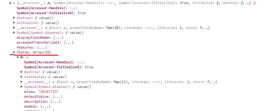

The results in the console log show that there are 32 fields:Dirk_Vandervoort_0-1712939819395.png

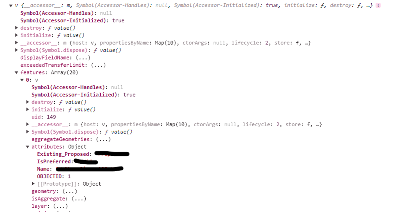

The results in the features.attributes only show 4 attributes:Dirk_Vandervoort_1-1712939899753.png
I understand that the local queries on the FeatureLayerView are supposed to be more performant than against the FeatureLayer. However, I can't get to 28 of the 32 fields I need to do interesting things. How can I get all the fields into features of my FeatureLayerView ?

You need to set the FeatureLayer.outFields property to get all the fields as explained in the doc.
