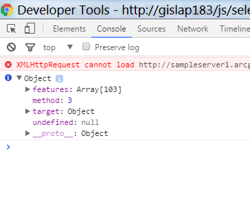

   Not sure how your code is handling the FeatureLayer.selectFeatures but this sample does return feature and method just fine (I just added a console.info(evt)):
ArcGIS API for JavaScript Sandbox
        censusBlockPointsLayer.on("selection-complete", function(evt) {
          console.info(evt);

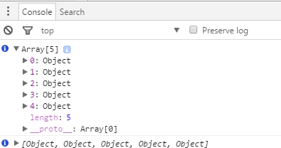

Could we do it in
function initFunctionality() {
var query2 = new Query();
query2.outFields = ["*"];
query2.where = "OBJECTID < 5";
censusBlockPointsLayer.selectFeatures(query2, FeatureLayer.SELECTION_NEW, function (featureSet) {
console.info(featureSet);
The print in console is the same: Array of Objects

   OK the difference is that you are using an inline deferred handler verses an on event deferred handler and the return is different by design for these. When you do a inline handler like you are the returned result is only an array of graphics as you would already have access to the selection method.
