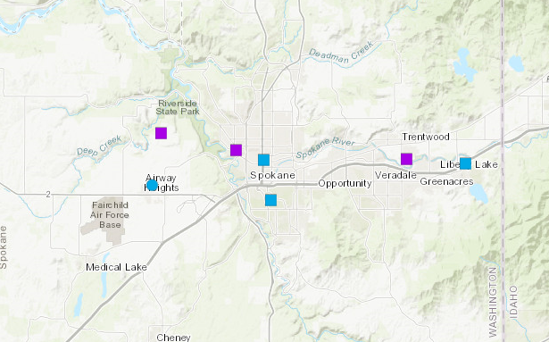

LoriEmerson_McCormack
It is working for me in 4.8.  See the map and the developer console messages.
ArcGIS API Sample using 4.8 and my feature layer -- mapArcGIS API Sample using 4.8 and my feature layer -- developer console messages
