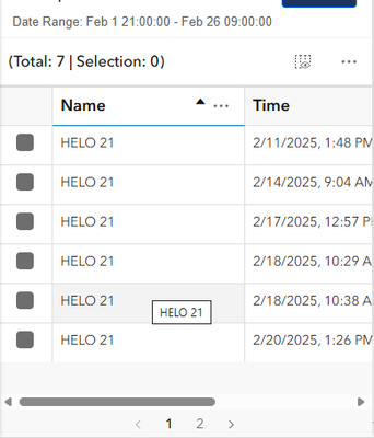

When the number of items in the layer is the same as the pageSize the featureTable displays blank.
    this.featureTable = new FeatureTable({
      view: this.view as MapView,
      layer: layer,
      visibleElements: { selectionColumn: true },
      container: 'tableDiv',
      tableTemplate: {
        columnTemplates: fieldColumnTemplates,
      pageSize: 7,
      paginationEnabled: true,
Here is the same data results if PageSize is changed to pageSize: 6,

Any suggested workarounds for this pagination issue that also results in a blank set of records on the last page?
I have tried to set the property effectiveSize as a workaround without success. It mentions how the last page may be handled differently.
https://developers.arcgis.com/javascript/latest/api-reference/esri-widgets-FeatureTable.html#effecti...
Right now either increasing or decreasing number of records by 1 to not be an even multiple of number of records / pageSize is the only working solution, but prefer to use a rounded number like 1000 total records and pageSize of 20 resulting in 50 pages.
