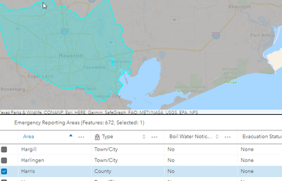

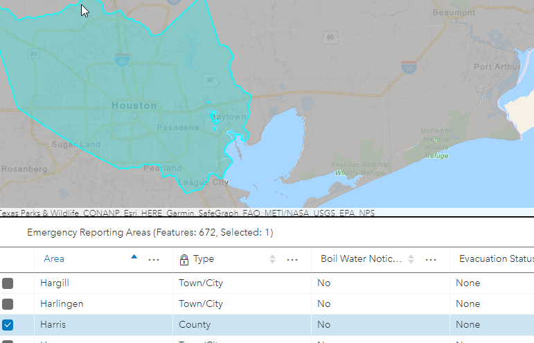

Brand new to Javascript so I'm hoping I'm missing something simple here, but I have a very simple page cloned from the feature table with editing enabled sample code but swapped out my own feature layer. For the most part it works great but if I tell the table to sort on a column, it will select the correct feature but push updates to a different one.
Here's where I select the record, I see the correct feature highlight.

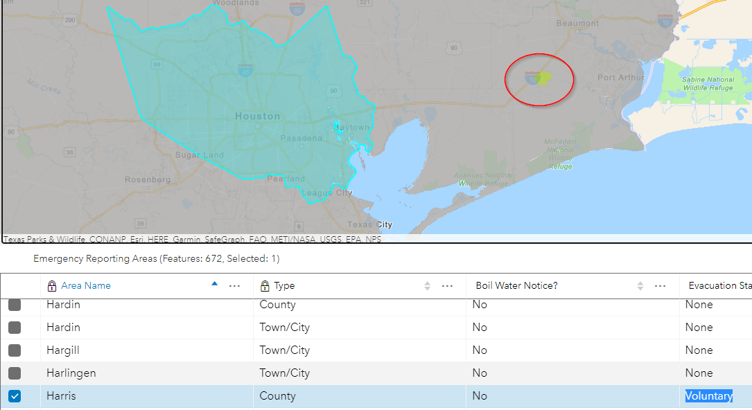

Changing the status field in the same record updates a different location.
This only happens if I include direction: "asc" in one of the field configurations. Assuming there is a place for me to identify the objectid?
Here's my page for reference. Thanks everyone
