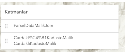

Hello
I want to change the names of the feature layers I captured via Enterprise.
Layers are shown with layerlist.
Can you help me change the names?
Sage_Wall
Hi @emreaktas1 ,
All you need to do is set the title property on the feature layer.
const featureLayer = new FeatureLayer({
  url: "url to the feature service",
  title: "Whatever you want to name the layer"
