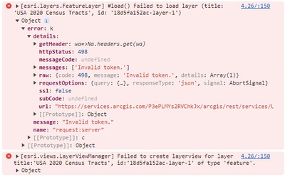

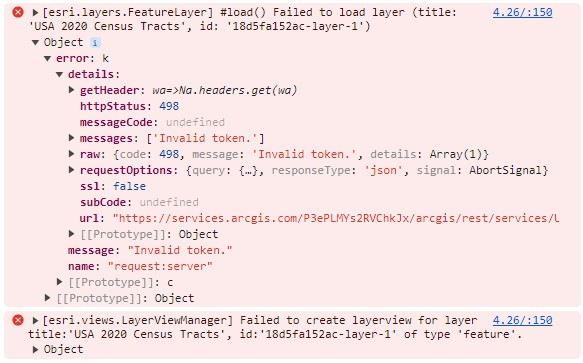

It's been loading fine in my apps until I added a referrer to the api key (so the api calls are restricted to my company's hosting server / can't be used elsewhere). When I set this, the layer now fails to load and gives me some error codes and messages:
  • httpStatus: 498
  • messages: Invalid token.
I've tried loading it with the new api key assigned in the feature layer token property and without assigning it - the same error happens. Can someone explain why this might be happening? I have a feeling it might have to do with setting the content item scopes but since this is external data, it's not really something I can set and I don't know a way around this.

This is because when I check the api request being made when the page loads, it's automatically assigning the private api key as a token for this layer:
I don't want to copy and paste the specific request here because it contains the api key, but I think I just need the request to be made without a token assigned. One other option is creating two api keys - a restricted one and non-restricted one to assign instead but I really don't want to host a public api key for security reasons. I'd rather just have no key be passed at all for this later since it's a publicly hosted layer. Is this possible?
