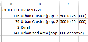

to export featuretable to csv but it produces a csv file with 2 fields including the objectid.

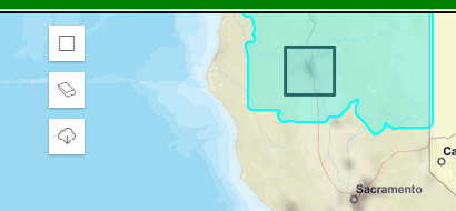

I first selected the features by the geometry.

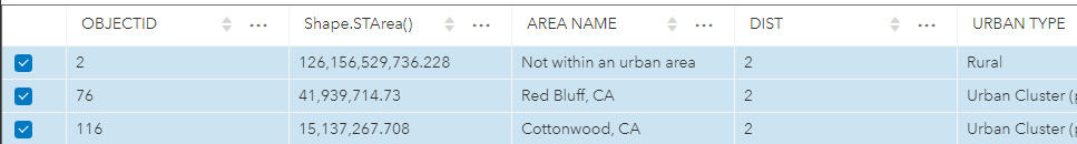

Then the feature table is updated to show selected features.
Then clicked on the export button to create the csv file but only one field  but records span across multiple fields!

The issue by now is exposed because one field is passed on to the CSV. Why?

LefterisKoumis
Thank you. I already had the query to outFields=["*"] but not the layer. Apparently, by not using the same for the layer it does not by default use all fields even though the featuretable displays all fields.
