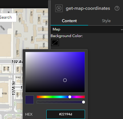

As a training exercise, I'm trying to extend the latitude/longitude example widget to offer a background colour changing option. Changing something like the map or dataset featured in a widget makes sense to me, but passing a custom prop like background colour seems more difficult.
Is this possible? I'll follow with my setting.tsx and widget.tsx.
Any help is greatly appreciated.

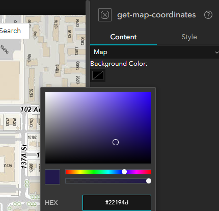

I'd like the user to edit the backgroundColor using something like this:

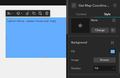

RalucaNicola1
First of all, most of the widgets have a background property that users can set in the style panel:
But as I understand, you want to do this for your own learning. Not sure if it's the best way, but the way I did it for a widget I once built, was to have a backgroundColor property in config.json. Then in the ColorPicker component I keep it in sync with the config property: see code. And onChange will update the property whenever the user changes it: see code. We can access this property in the widget props (the config is set on the widget props)

succip
This works as intended and I finally understand how this works. Thank you so much for your help!
