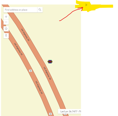

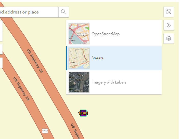

I inherited this application... Its a .net app with some JS in it... a very simple map....
I have a few widgets in the map ... Legend, Basemap, LayerList

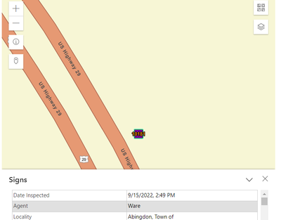

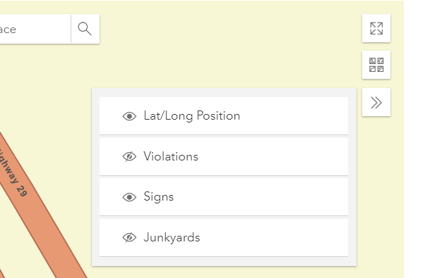

When I click on the widget after the page first loads I get the intended result... it opens in the map and gives me my selections:

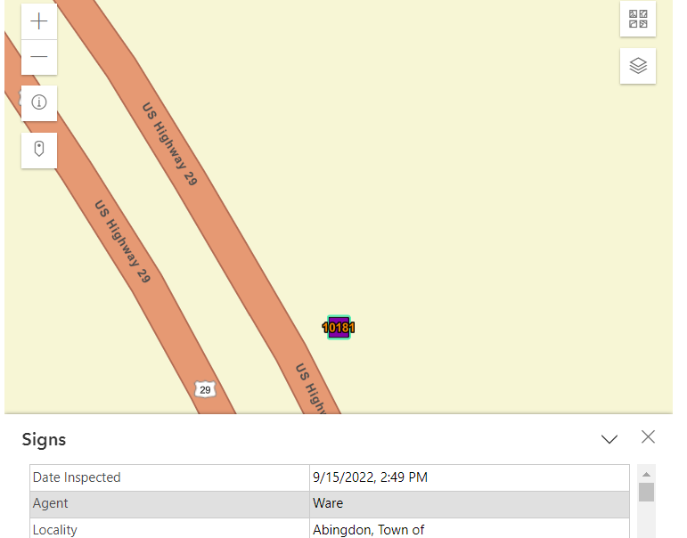

I then click the Point in the map and once again I get the intended result... the popup is embedded in the map...

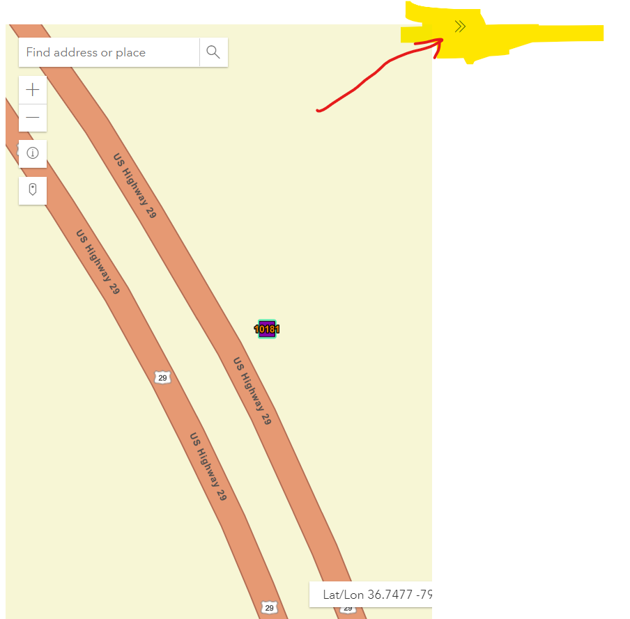

The problem is that after clicking the Feature in the map and closing the popup table and then going back to either of the widgets it no longer opens in the map rather its like a huge side bar that opens...
AND it only shows the required choices once I make the browser window really small...
Is there a particular piece of code that I can look for that would force this side bar opening?  I have been trying to hunt this down and cant seem to find anything that would be causing this..
Any thoughts would be greatly appreciated....
kapalczynski

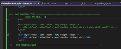

It appears the issue was with css and using the "
esri-view-width-xsmall
I removed this and the expand widgets started working as I expected... and as a result the docking of the popup was not working as expected.  As a result I move the popup box outside the map into a DIV and worked from there...
It appears the CSS was making the page believe it was xsmall and as a result it opened the expenad widgets in a side pane and the popup in full with docking format... this is not what I wanted ... as a result I move the popup outside the map

Do you know which arcgis js version its using? Do you have any code you can share?
kapalczynski
<script src="https://js.arcgis.com/4.26/"></script>
There are 2 maps here 2nd one around line 372... this is as far as I have been looking at this point...
So weird because as show in image above when the side panel opens there are now values in it.. but if I minimize the screen and do again they then appear... then resize to max and they show up again... so weird... I hate reengineering someone's work... And to boot im not a full time programmer...

kapalczynski
I think I may have just found it... but now my popup is no longer docking... uggggg...
The Maps Container is set to applicationView as seen below... I removed the "esri-view-width-xsmall" and the side panel is not appearing any longer... not sure if this was it but still testing...
but as I stated this now has stopped my popups from docking automatically... not sure how to make that happen... I think the popups were docking automatically because of the "esri-view-width-xsmall" setting and now that I removed it its allowing them to free float in the map... BUT I do not want this...
how do I default them open and docked when a feature is selected.
        <div style="float: left; width: 70%; height: 600px;">
            <div id="applicationView" class="applicationMapStyle esri-view-width-xsmall"></div>
        </div>
I figured this would do it...

kapalczynski
Yup if I remove the "esri-view-width-xsmall"  then the side pane no longer appears BUT it no longer docks...
I commented out the OLD breakpoint and added the one below... from what I read this should dock no matter what... WHY are my popups not docking?
breakpoint: true

I tried this approach to get the popup outside the map and into its own DIV and its working good...
BUT its not showing me the attachments in the popup... HOW do i show attachments with this approach?

kapalczynski
