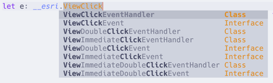

I use Angular/TypeScript and need to know the type of Events with view.on() like:
view.on("click", async (event) => { ..... });
view.on("immediate-click", async (event) => { ..... });
Where/how can I find the definition of the types in ArcGIS Maps SDK for TypeScript?
Thanks.
Forrest

All the TS Typings are defined by the public documentation. debounce for example depends on the function being debounced, it just takes a generic function
https://developers.arcgis.com/javascript/latest/api-reference/esri-core-promiseUtils.html#debounce

ReneRubalcava
Esri Frequent Contributor
These are available under the __esri TS namespace
