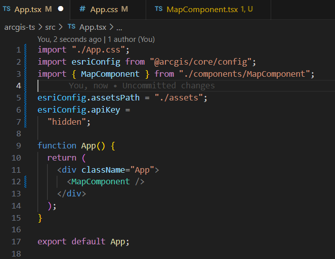

Hi, I decided to try out a tutorial using the JS SDK, using React, but I am having an issue mentioned in the title.
The app is a simple react app made using npx create-react-app my-app --template typescript.
https://developers.arcgis.com/javascript/latest/display-a-map/ The idea was to follow this tutorial.
I add the needed imports as so, which are:
import Map from "@arcgis/core/Map";
import MapView from "@arcgis/core/views/MapView";

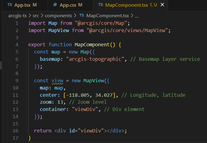

and then create a component called MapComponent, which just returns a div as such:
<div id="viewDiv"></div>
but then I end up getting the error in the title. I read that you need to set the parent's height to workaround it, but to no avail.
mmatusova_0-1683399412132.pngmmatusova_0-1683399412132.pngmmatusova_1-1683399433852.pngmmatusova_1-1683399433852.png
The values and names are from the tutorial above.

Hi @mmatusova, I think the issue is that you are calling the js function before the div is rendered causing it not to find it. I think you can use useEffect hook for this.
export function MapComponent() {
    const loadMap = () => {
        const map = new Map({
            basemap: "arcgis-topographic"
        const view = new MapView({
            map: map,
            container: "viewDiv"
    useEffect(() => {
        loadMap();
    return <div style={{ height: 100, width: 500 }} id='viewDiv'></div>

mmatusova
Hi @RamaniGanason !
I ended up figuring it out later on that day fortunately, but thank you so much for confirming this is the right way to do it! 😃
