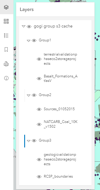

Here is an image of my LayerList()

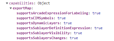

Here is the properties that the cache is showing:
Any ideas as to what is going on and how to fix it?
