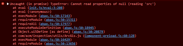

I am using the Esri web map in one of my SAPUI5 projects. The map loads fine locally while developing but when I deploy the app to SAP launchpad, the map stops loading with the error below-
Can anyone please give me some hints?

Can you find the appropriate request in the network traffic? There might be a resource that is being accessed locally that is being lost when moved to production or another environment.
