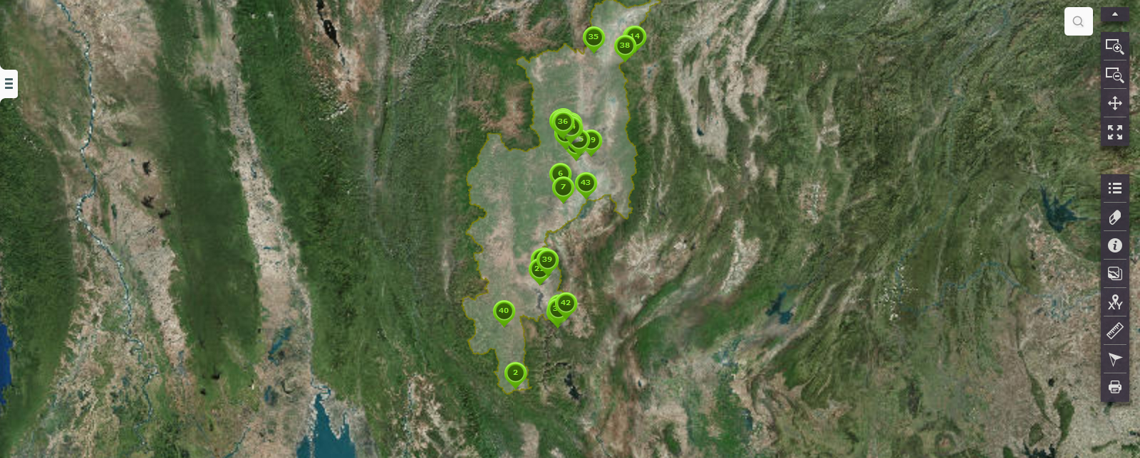

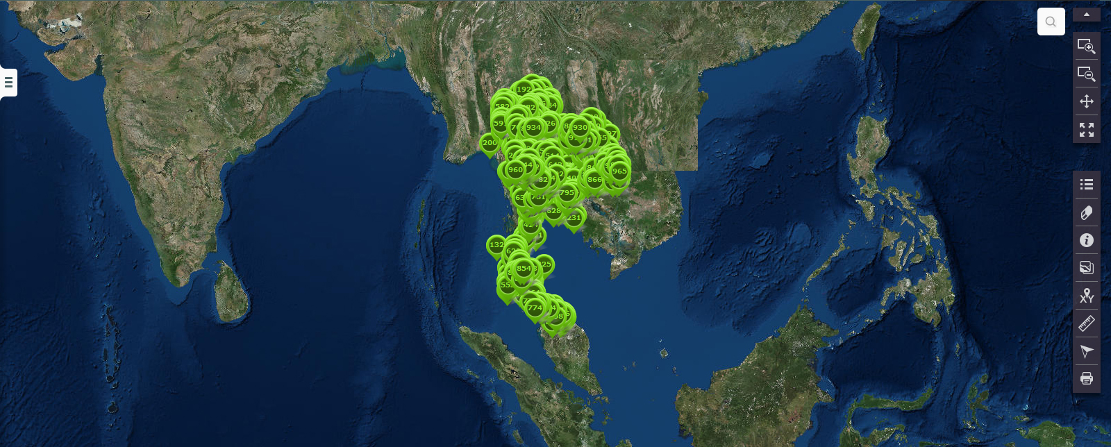

In my website, there is one function that can save the image from current Map Application. Sometimes it needs to produce numbered pin for locating various places. Sometimes, it is around 20-30 pins. It can go up to around 1000 pins in some cases. (Example is the below images). Then I used PrintTask to call PrintingTools to produce the map image.

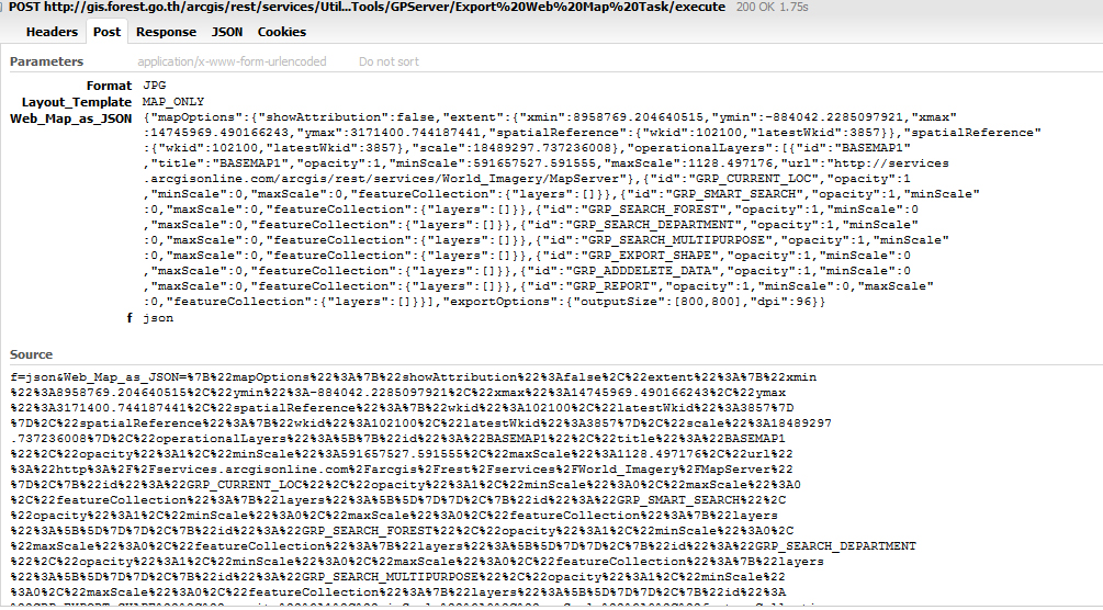

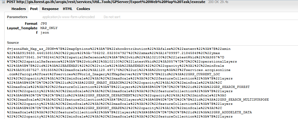

When I try to check the error, I'm not sure whether it is related to the parameter that are sent to PrintingTool? I saw that sometimes some parameters are lost, like in the below image.There is no parameter "Web_Map_as_JSON" even though the source stated that it also send this parameter on Json
Parameters when somehow it didn't work
Parameters when it worked
