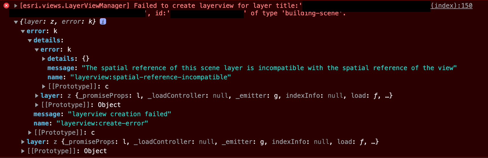

Hi all.
I am struggling to display a hosted scene layer on the web application. The layer is a 3d model of a floor in a building. (Due to security issue, I am not able to share the access of the layer)
I initiate the scene as the following
const bSceneLayer = new BuildingSceneLayer({
url: my_url,
const map = new Map({
basemap: "osm-light-gray"
const view = new SceneView({
container: "viewDiv",
map: map
map.add(bSceneLayer);
The error below returned and the layer was failed to displayed.
I also tried to comment out the basemap property. Then the scene layer showed correctly but another camera error occurred (illustrated in another post). How to resolve this error?
Besides, is there any option to avoid basemap rendering? I just want a plain background with the 3d model on top.
Thanks for everyone helping.
ArnoFiva
Similar to your other question regarding camera, the spatial references of the "osm-light-gray" basemap does not match with the one from your building scene layer. Either you have to provide a basemap in the same spatial reference, or you have to initialize the Map object without a basemap.
