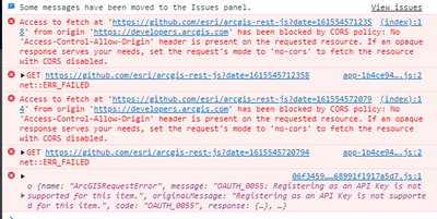

TorbenJorgensen
I am having the same problem
Snip of console
LaurenBoyd
Hi @TorbenJorgensen -
If you're using a Community, Trial, Evaluation, and Personal use subscription to sign in to the developer site, you will receive this error since you cannot create API keys with this type of account. The user experience for these subscription types will be enhanced in a later update to the site.
To get around this, you will need to create a new free developer account: https://developers.arcgis.com/sign-up/ or sign in to an organization account that is not one of the subscription types listed above. Hope this helps!
Lauren
