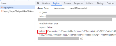

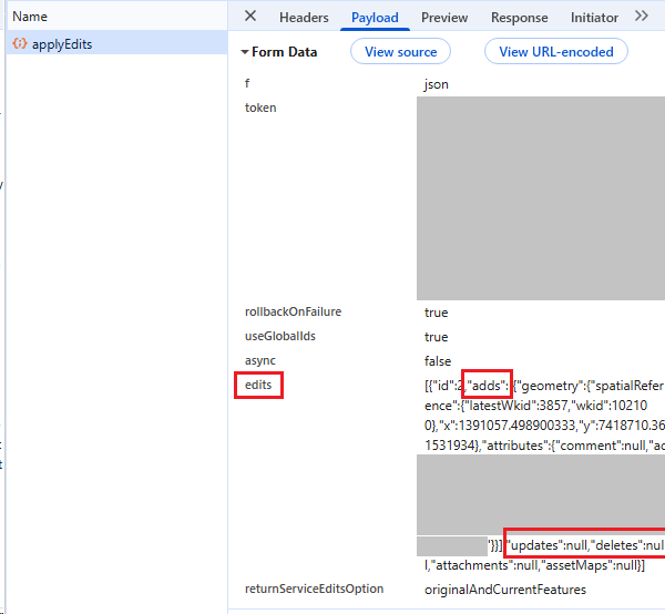

payload of applyEdits with adds-object nested in edits-object:

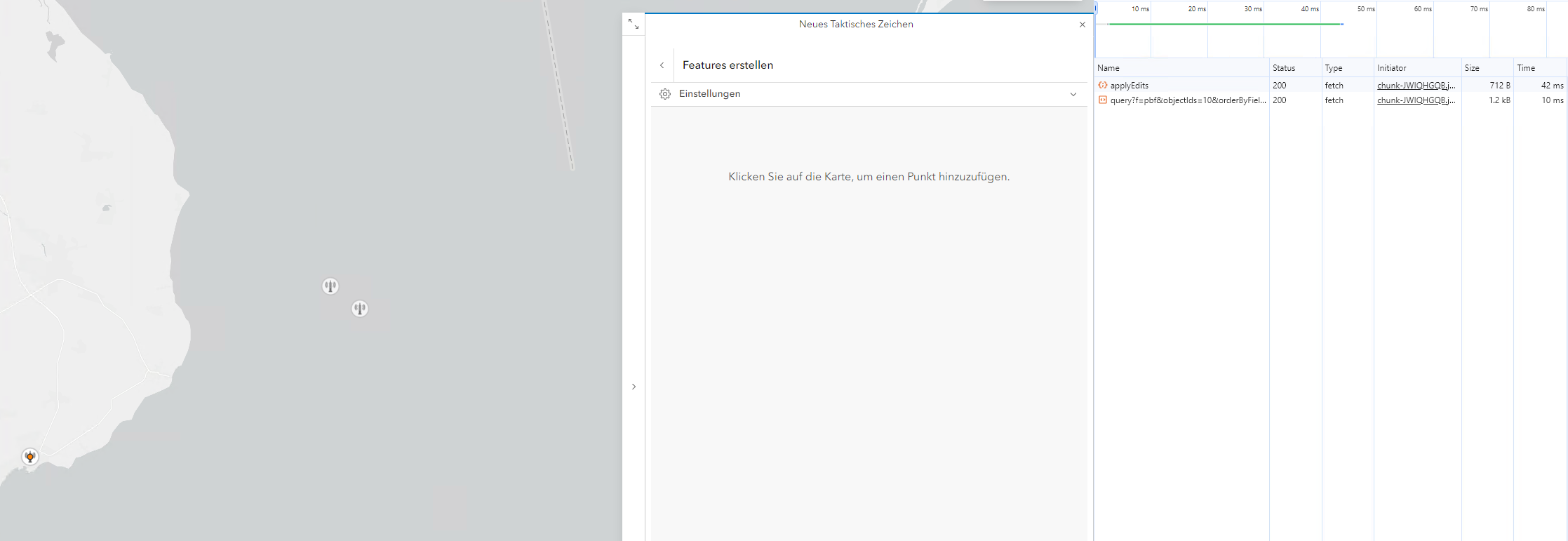

Since we copied the app code from another app (called A) and modified some other things I tried the same there and:
The other app immediately is showing the new feature and I can see a query in the network tab.

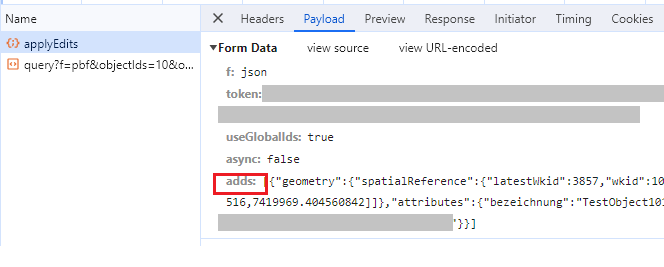

payload of applyEdits with adds-object:
So both apps, being clones but used in different deployments do different things.

directy uses 'adds'-object in payloadnests the 'adds'-object inside an 'edits'-object also containing nested 'edits' and 'deletes' with null

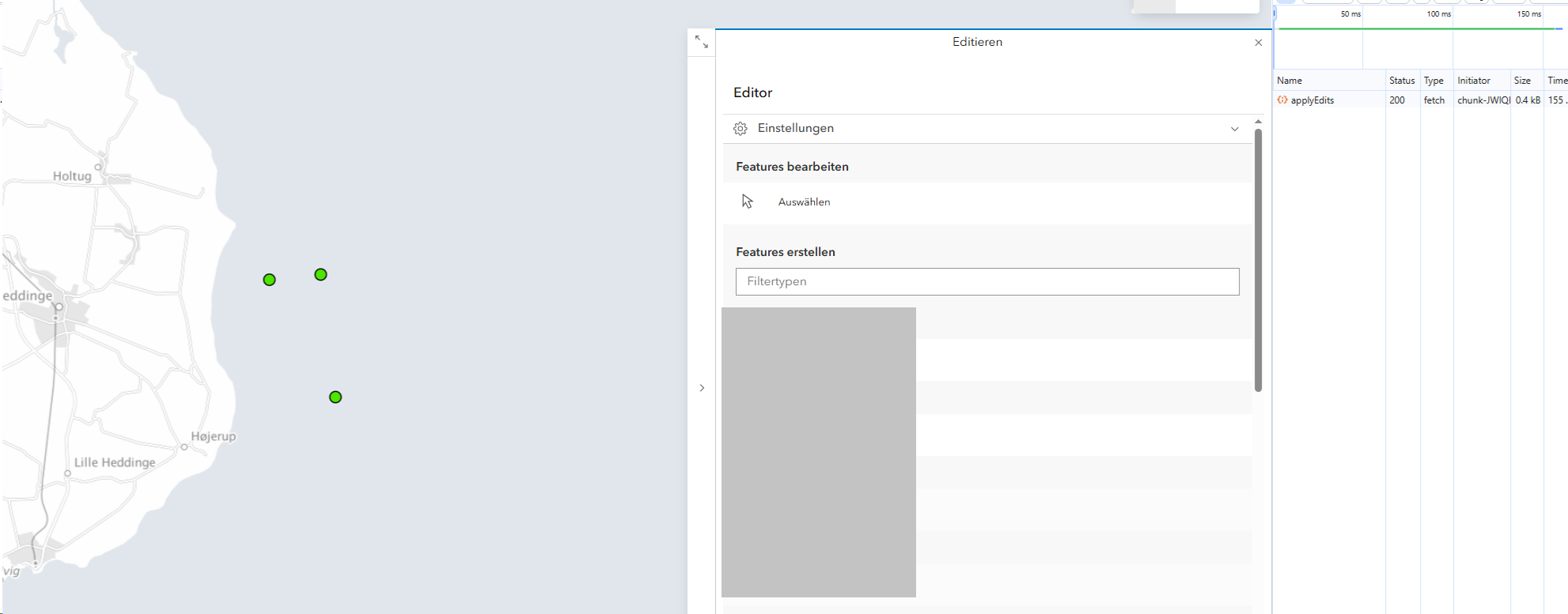

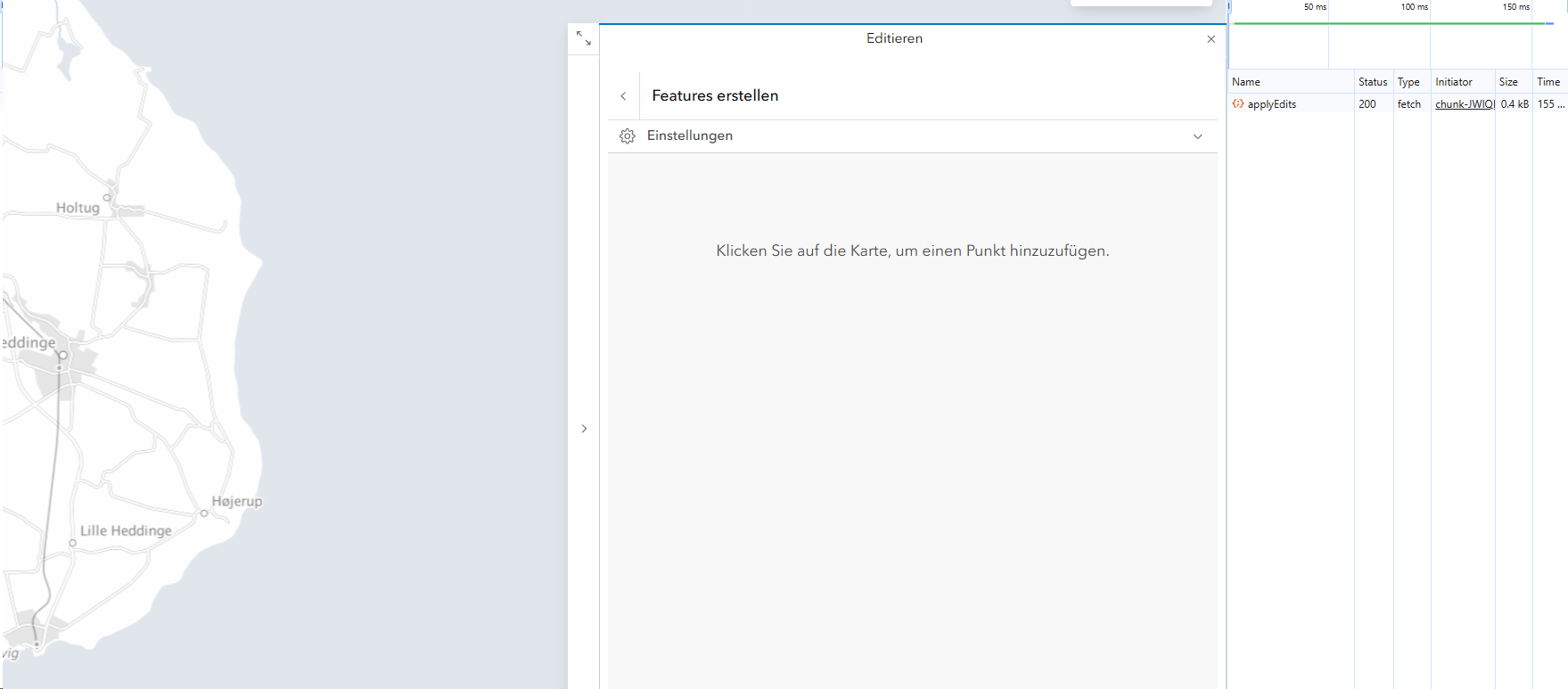

We just found out, that this behaviour also appears within ExperienceBuilderApps. Using the editor widget does not show the Feature unless one forces a query by either reloading or heavy zooming.
Guess thats a BUG though.
