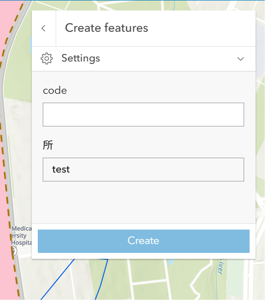

Is there any event for "editing/create features" window open ?
What I want to do is to validate the input is valid or not ,if not to disable the "create/update" button after the window popup. Before the window popup can not get the button dom.
js SDK verison: 4.28
