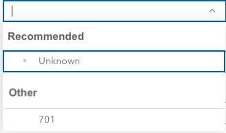

And the list of options, instead of having five options in the dropdown list, I got one recommended  (which is not supposed to be there ) and one more (no label just code) which is a current value.
