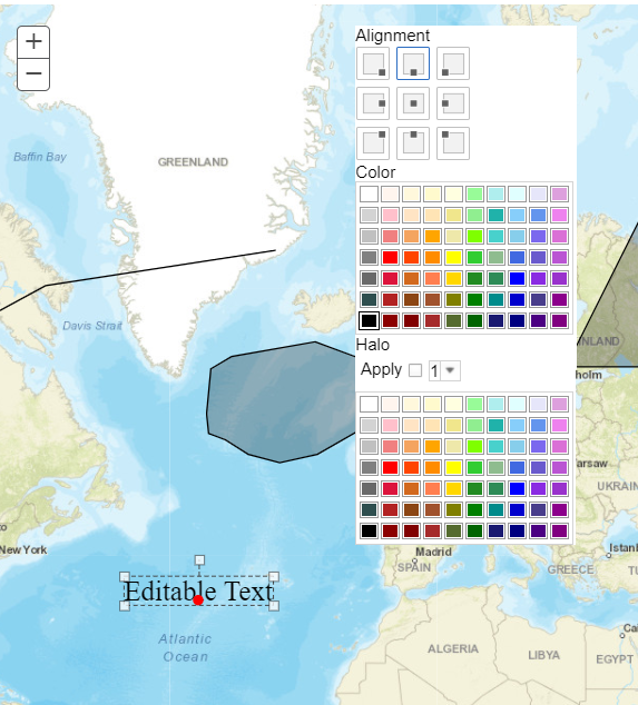

I am using ArcGIS Javascript API version 4.15 for my desktop web application, and want to draw/edit text symbol on map click.
Have seen an example in sample Editing Tools. if you see the sample link, the text is editable and a color popup appears on click of text.
trying to replicate the same feature in the 4.15 version, but no luck.
