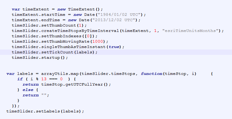

Hi all,

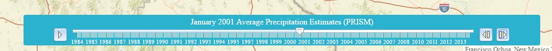

I was wondering how to just display the tick marks that correspond to the labels in the time slider?
For example, I want to put a tick mark every January of YYYY.
I'm getting a tick mark for every time interval which is every month from 1984 to 2013.
Thanks for all your help!
Francisco

Hi Tom,
I've tried the following but I'm still getting some errors. It returns tick marks just on the first and last month of my dataset. Am I missing a parameter??
Labels is a global variable.
Francisco

Fransisco,
setTickCount is expecting a number.  Since labels is an array, you could do:
timeSlider.setTickCount(labels.length);

NMWater
Thanks for all your help Tom! Unfortunately, I think some part of my labels is undefined as a console.log() is indicating.
Kindest Regards,
Francisco
