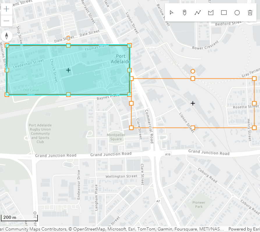

Hi All,
I've created a sketchViewModel to create and edit graphics in a graphics layer following this sample: SketchViewModel Styler | Sample Code | ArcGIS Maps SDK for JavaScript 4.30 | Esri Developer
Though I am experiencing some odd behaviour where the orange 'edit' box stays behind as I drag the graphics around, see the below screenshot.
Does anyone know what the issue is or has any tips for debugging?

JoelBennett
MVP Regular Contributor
I haven't tested this, but it seems likely to me that the problem you're experiencing is related to having two SketchViewModels in play at the same time.  In the JS code, one is found on line 108, and the other on line 147.  Since it doesn't appear that you're actually using the Sketch widget instantiated on line 103, you might try removing it altogether.
JoelBennett
JamesIng
@RileyLum2  - Have just tested it and @JoelBennett  is correct if you remove the sketch widget instantiated on line 103, it'll fix the double box editor issue.
